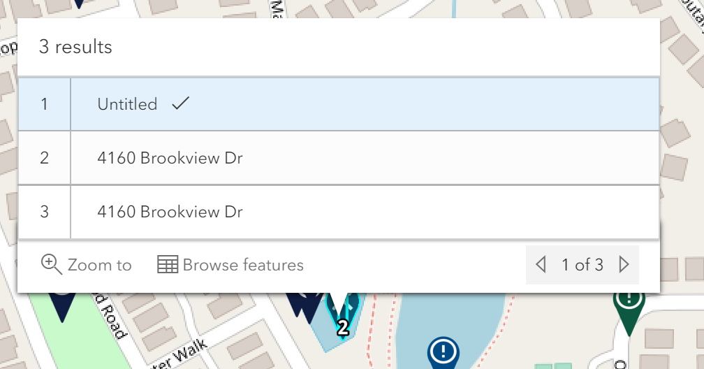

ArcGIS Javascript adding an extra row to featurereduction popup

geoJSONLayer.featureReduction = {
          type: "cluster",
          outFields: ["*"],
          popupTemplate: template,
          clusterRadius: 25,
          clusterMinSize: "50px",
          clusterMaxSize: "50px,
          labelingInfo: [
              deconflictionStrategy: "none",
              labelExpressionInfo: {
                expression: "Text($feature.cluster_count, '#,###')",
              symbol: {
                type: "text",
                color: "white",
                font: {
                  weight: "bold",
                  family: "Noto Sans",
                haloSize: 1,
                haloColor: "black",
                yoffset: "-8pt",
              labelPlacement: "center-center",

 Here's the code to how I solved it!
ReneRubalcava
Esri Frequent Contributor
Does your PopupTemplate have a title property? If it doesn't, you get this "Untitled" text for the summary row. You can review this sample to help.
https://developers.arcgis.com/javascript/latest/sample-code/sandbox/?sample=featurereduction-cluster
GeospatialEnterprise
That syntax was very annoying.. It was counting the summary and it makes it appear as if there were an additional feature in the scroll. I ended up bypassing the browse features button with view.popup.open for the cluster features and the popup template for the single points!
