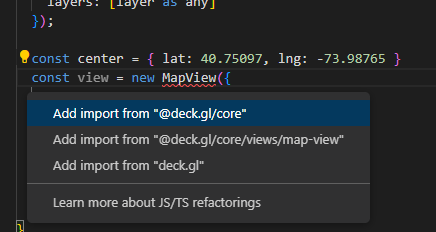

Without my definition file, no suggestions show up for esri imports:

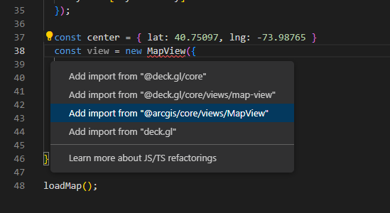

With my definition file, I get auto complete suggestions:

Not sure. Looks like vscode isn't scanning all the d.ts files. Not much we can do to force it to work. Maybe a way to configure this in the jsconfig for vscode, but not something I've looked into. Relying on module names for autoimports is a little iffy because default imports aren't named, so you can call SceneView, ArcGISSceneView, or SV, so not sure how vscode handles that.

warming up this topic one year after the fact.. I hope it's not too late for you. I've had the exact same issue in projects using @arcgis/core (ESM), no matter which other tools (webpack, vite, react, ...) were involved. The solution: Explicitely include the definition in tsconfig.json like:
"include": ["./src/**/*", "./node_modules/@arcgis/core/**/*.d.ts"]
With this entry I have auto import in all of my projects, while intellisense and type checking did work without it. ✌️
