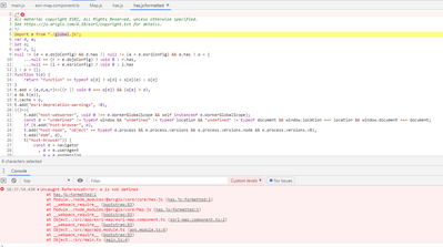

Hi everybody,
   I'm trying to include ArcGIS JS API 4.19 in my Angular 8 project.
   The project was created by command "ng new esri-js-webmap" and it installed "arcgis/core" only by command "npm install @arcgis/core".

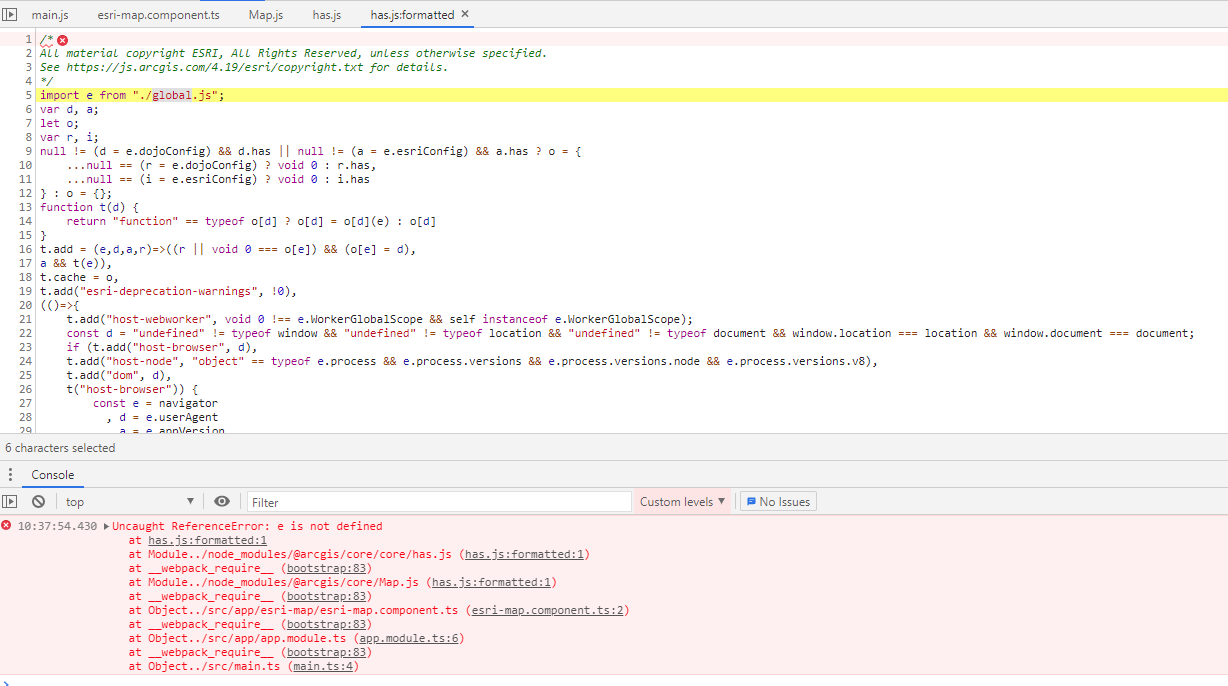

  After compile success, I got the console error "Uncaught ReferenceError: e is not defined" in the default site "localhost:4200".
It happens when "import EsriMap from "@arcgis/core/Map";" in src\app\esri-map\esri-map.component.ts

After checking the document , I upgrade Angular to 11.2.13 and everything works fine.
