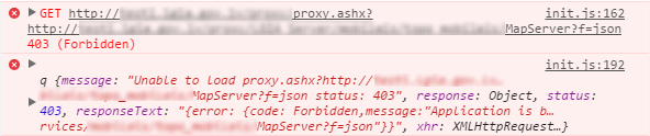

Google Chrome console after changing API to 3.11

Raimonds,
   You are mixing protocols and different API versions in your code.
Try::
<link rel="stylesheet" href="http://js.arcgis.com/3.18/esri/css/esri.css">
<script src="http://js.arcgis.com/3.18/"></script>‍‍
Notice both use http protocol and both are calling the same version of the API.

http or https protocol/same or differen API version its does not matter. Same error after v3.11.
Can anyone write working example for using proxy and custom basemap that works whit newest ArcGis Javascript API?

Raimonds,
   This worked fine for me:

Notice the removal of mixed AMD and Legacy coding patterns like you had and the use of the same api versions for both the css files and the js api files.
I could not find a tiled/cached map service for your country so I switched to a ArcGISDynamicMapServiceLayer.
