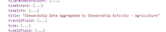

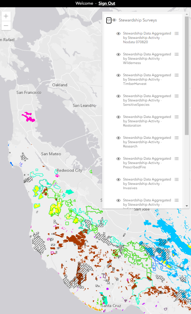

I'm trying to access a WFL with 14 layers on it. I successfully pull all the layers off the service and display them on a map and in a layerList widget, but I would like to edit the featureLayer.title attribute to remove the prefix that ArcGIS Online adds to all layers within a WFL. (The WFL is named "Stewardship Data Aggregated by Stewardship Activity" and the individual layers have names like "Agriculture", "Wilderness", "Grazing", etc. - I want to just display the end portion of the full name.) When I console.log(featureLayer.title), I am only shown the prefix part ("Stewardship Data Aggregated by Stewardship Activity"); however, when I actually inspect the featureLayer object, I can see that the title is really something like "Stewardship Data Aggregated by Stewardship Activity - Agriculture"
Is this a bug in featureLayer.title? When I later try to substring(54) the title, it returns an empty string. What am I doing wrong?!?! (code below)
