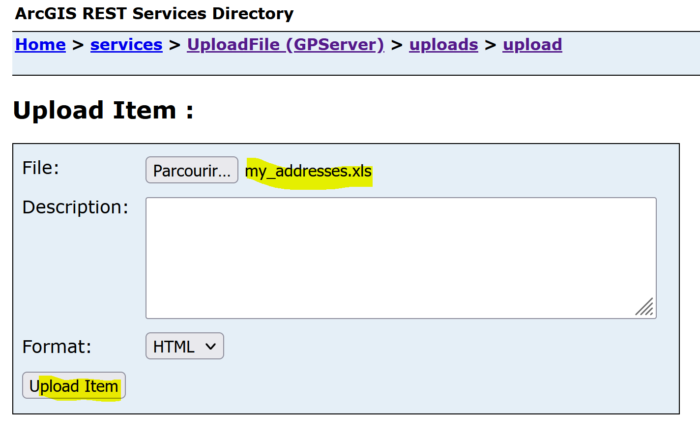

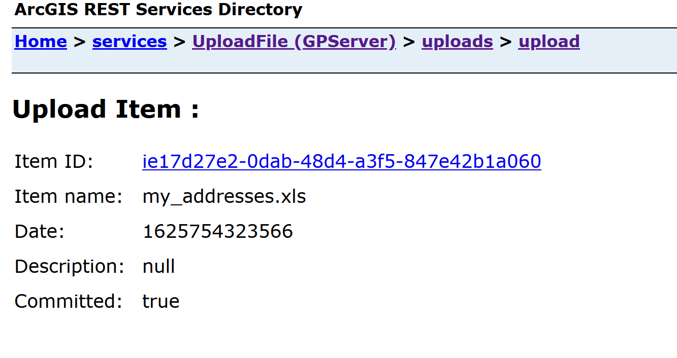

I created a gp service that allows to load a csv file (It contains addresses and It is attached at this post).
It works as expected :
https://supad-t1-age1081.westus2.cloudapp.azure.com/server/rest/services/UploadFile/GPServer/uploads...
I get an Item ID.

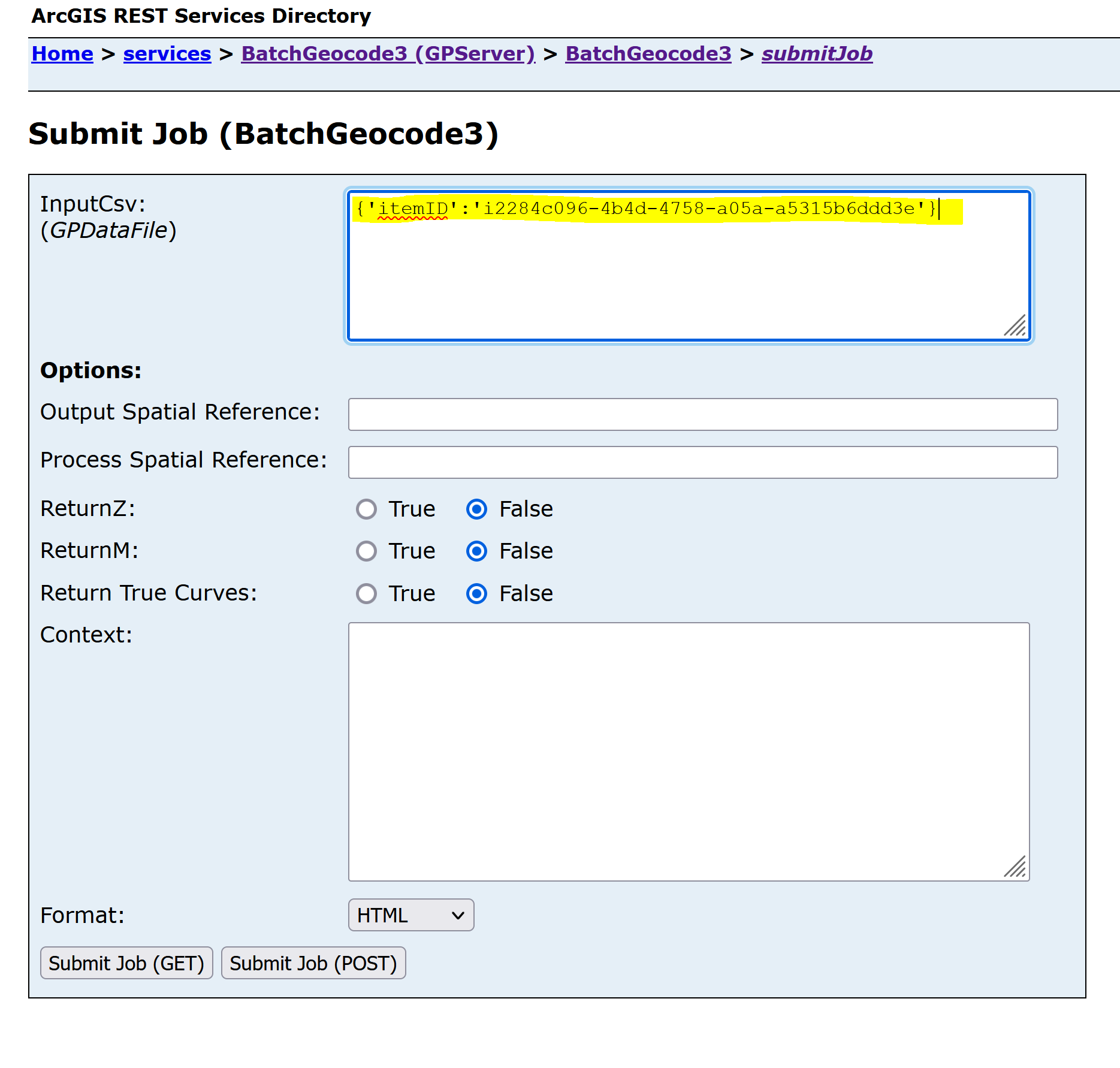

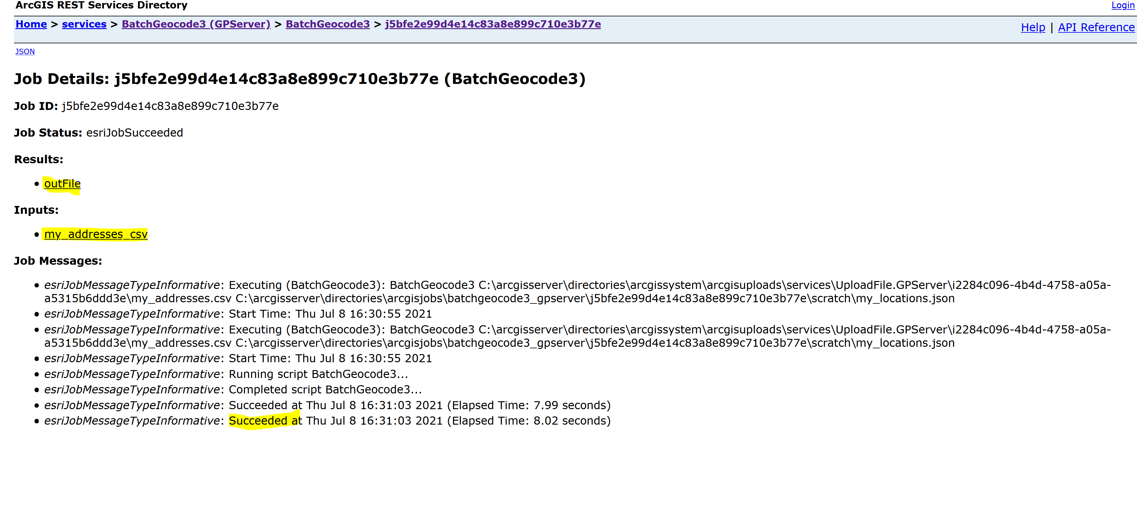

I created a gp service that allows to geocode addresses (from the Item ID generated at the step previous) :
https://supad-t1-age1081.westus2.cloudapp.azure.com/server/rest/services/BatchGeocode3/GPServer
Bertrand_Laurancin_3-1625754996734.pngBertrand_Laurancin_4-1625755028564.pngBertrand_Laurancin_5-1625755065516.png

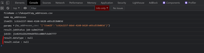

      function errBackUplaod(error) {
        console.log("upload: ", error);
      function errBack(error) {
        uploadStatus.innerHTML = "";
        uploadStatus.innerHTML = "Error: " + error;
        console.log("gp error: ", error);
      function progTest(value) {
        document.getElementById("upload-status").innerHTML = "Job status: " + "'" + value.jobStatus + "'";
        console.log(value.jobStatus);

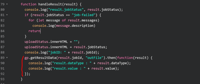

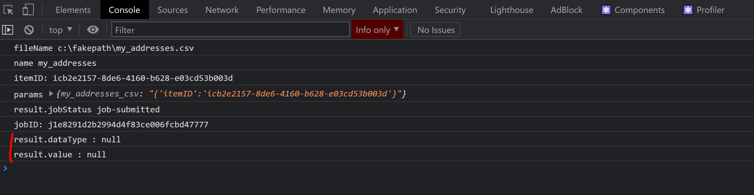

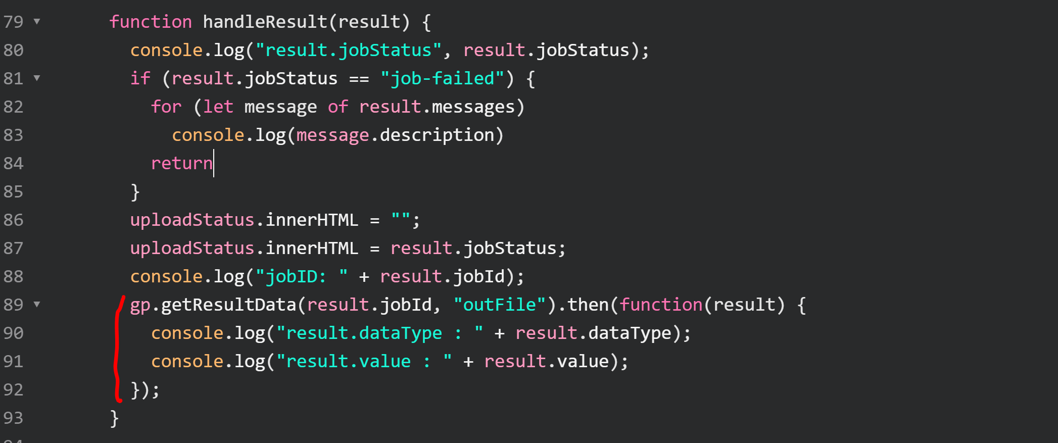

      function handleResult(result) {
        console.log("result.jobStatus", result.jobStatus);
        if (result.jobStatus == "job-failed") {
          for (let message of result.messages)
            console.log(message.description)
          return
        uploadStatus.innerHTML = result.jobStatus;
        console.log("jobID: " + result.jobId);
        gp.getResultData(result.jobId, "outFile").then(function(result) {
          console.log("result.dataType : " + result.dataType);
          console.log("result.value : " + result.value);

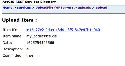

      function uploadSucceeded(result) {
        let element = document.createElement('html');
        let itemID = "";
        let itemURL = "";
        element.innerHTML = result.data;
        let tdElements = element.getElementsByTagName('td');
        for (let tdElement of tdElements) {
          if (tdElement.innerHTML == "Item ID:") {
            itemID = tdElement.nextElementSibling.firstChild.innerHTML;
        if (itemID == "") {
          console.log("Could not get file item id");
          return
        console.log("itemID: " + itemID);

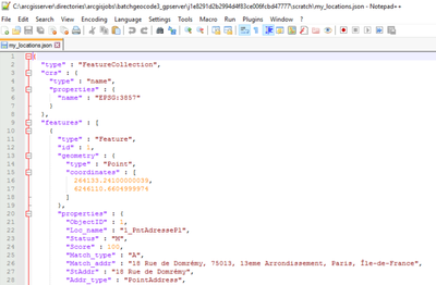

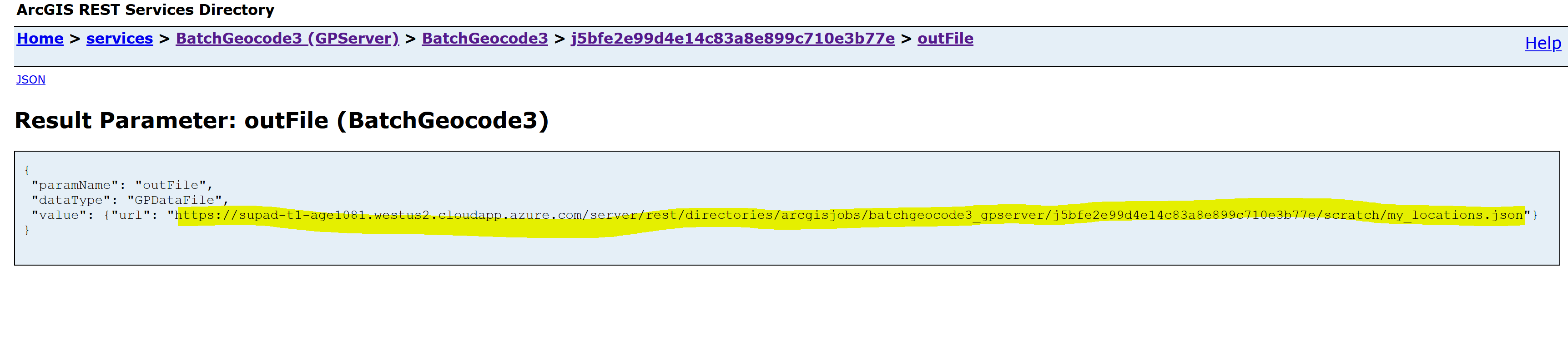

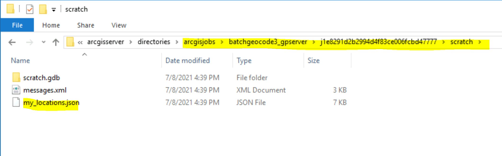

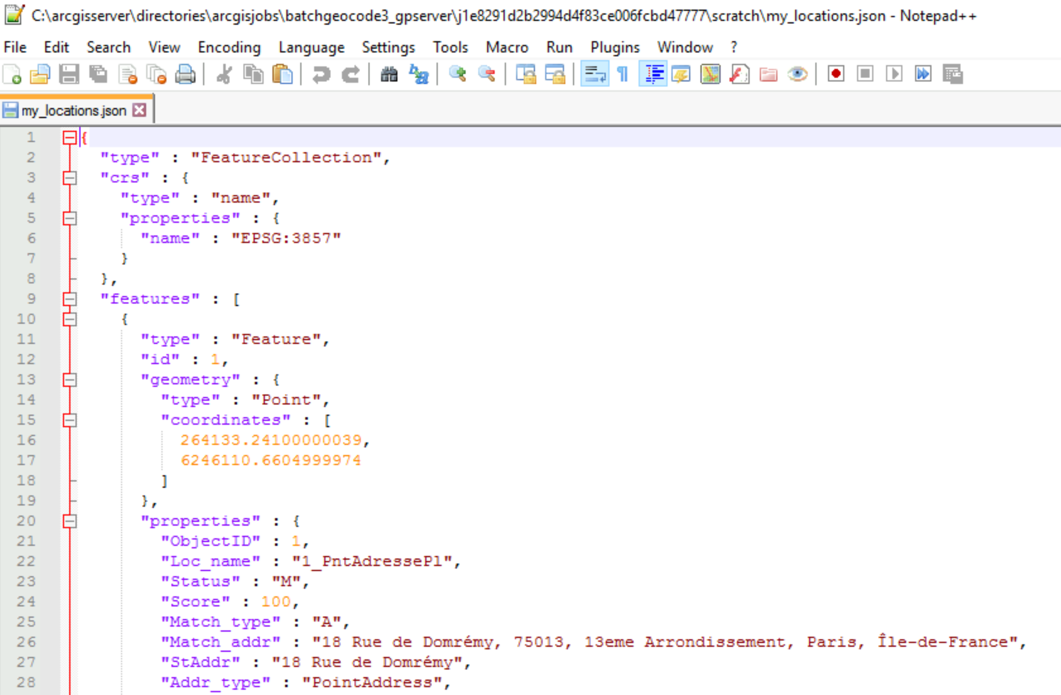

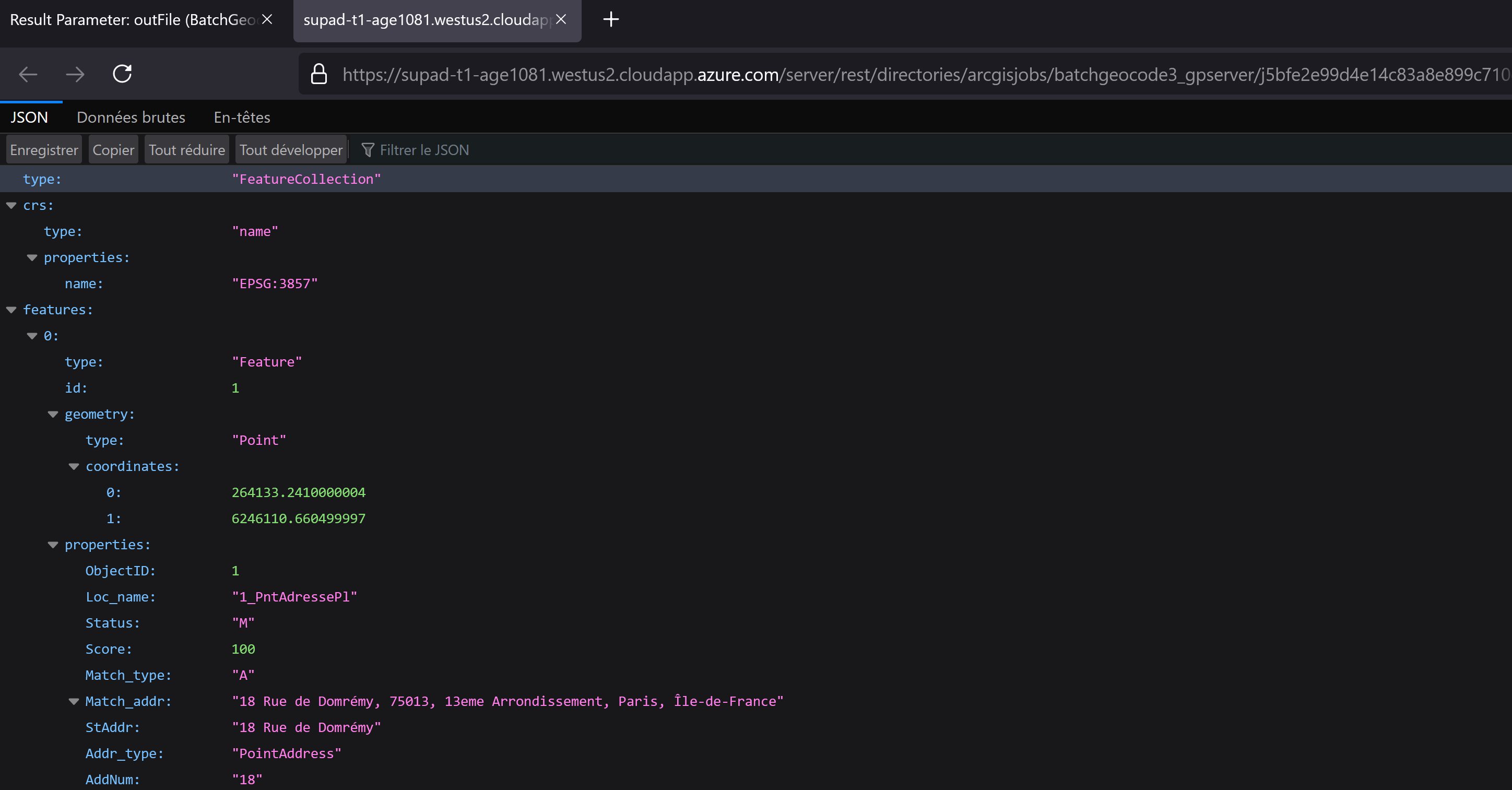

It works. The json output file is created on the server in \arcgisjobs\batchgeocode3_gpserver\<ID>\scratch:
However, I'm not able to get the result in the client-side (web app).
I think I must use waitForJobCompletion() method but I tried unsuccessfully.
Could you help me please ?
