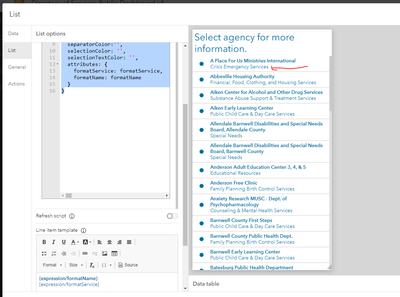

Thanks, Josh for your comment. I really appreciate your help. I'm trying to configure pop-ups on the dashboard. The full code is following-
var formatService = When($datapoint["services_offered"]=='Health_Department/Clinics','Health Department/Clinics',$datapoint["services_offered"]=='Violence_Neglect_&_Abuse_Relate', 'Violence, Neglect, and Abuse Related Services', $datapoint["services_offered"]=='Healthcare_Services', 'Healthcare Services', $datapoint["services_offered"]=='Financial_Food_Clothing_&_Housi', 'Financial, Food, Clothing, and Housing Services', $datapoint["services_offered"]=='Violence_Neglect_&_Abuse_Relate', 'Violence, Neglect, and Abuse Related Services', $datapoint["services_offered"]=='Educational_Resources', 'Educational Resources', $datapoint["services_offered"]=='Pregnancy_Crisis_Services', 'Pregnancy Crisis Services', $datapoint["services_offered"]=='Child_Care_&_Day_Care_Services_', 'Public Child Care & Day Care Services', $datapoint["services_offered"]=='Counseling_&_Mental_Health_Serv', 'Counseling & Mental Health Services', $datapoint["services_offered"]=='Adoption_Choices', 'Adoption Choices', $datapoint["services_offered"]=='Crisis_Emergency_Services', 'Crisis Emergency Services', $datapoint["services_offered"]=='Employment_Services', 'Employment Services', $datapoint["services_offered"]=='Family_Planning_Birth_Control_S', 'Family Planning Birth Control Services', $datapoint["services_offered"]=='Health_Related_Other_Resources', 'Other Health Related Resources', $datapoint["services_offered"]=='Legal_Services', 'Legal Services', $datapoint["services_offered"]=='Pregnancy_Crisis_Services', 'Crisis Pregnancy Services', $datapoint["services_offered"]=='Special_Needs', 'Special Needs', $datapoint["services_offered"]=='Substance_Abuse_Support_&_Treat', 'Substance Abuse Support & Treatment Services', $datapoint["services_offered"]=='Transportation', 'Transportation', defaultValue)

This code is working fine. However, I need to show two services for some areas. I tried different ways including your suggestion. But I haven't come up with any solution yet.
I'm trying to add another service in pop-ups (see red arrow on the image)

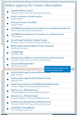

Hoquez
It can't execute arcade scripts.

The data come from a hosted layer generated by a survey through survey123. In that survey, one question was about which services are available. There are 7/8 options for that question.
Hoquez
For example, there are three services here.
Hoquez

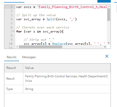

No problem! I was writing up a possible expression for you to use that makes use of Split and Decode:
var svcs = $datapoint['services_offered']
// Split up the value
var svc_array = Split(svcs, ',')
// Iterate over each service
for (var s in svc_array){
    // Strip out "_"
    svc_array[s] = Replace(svc_array[s], '_', ' ')
    // Format remaining values
    svc_array[s] = Decode(
        svc_array[s],
        'Violence Neglect & Abuse Relate', 'Violence, Neglect, and Abuse Related Services',
        'Financial Food Clothing & Housi', 'Financial, Food, Clothing, and Housing Services',
        'Counseling & Mental Health Serv', 'Counseling & Mental Health Services',
        'Family Planning Birth Control S', 'Family Planning Birth Control Services',
        'Substance Abuse Support & Treat', 'Substance Abuse Support & Treatment Services',
        svc_array[s]
// Merge values back into single string
return Concatenate(svc_array, ', ')
Testing it out on a sample value like Family_Planning_Birth_Control_S,Health_Department/Clinics, I get the following response:
