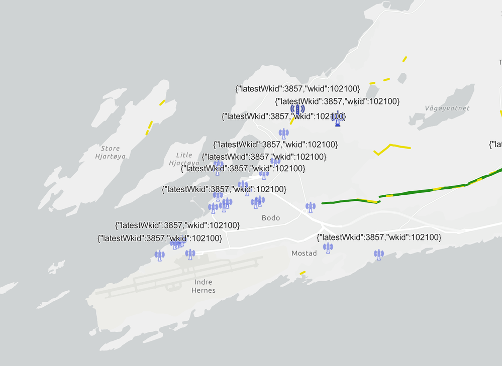

EmilAura
Hi,
I've attached a screenshot with
Text(GetEnvironment().spatialreference)
I see that I wrote PopUp, while I meant to write labels in my previous message
