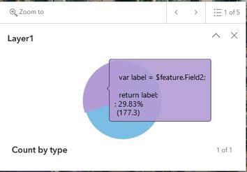

I am trying to get a field value from a feature using Arcade and pass it to a label for a chart in a popup.
I create the expression outside the JavaScript to get the field value:
<script type="text/arcgis-arcade" id="field-name">
  var label = $feature.Field2;
  return {label};
</script>
 Then I reference the script:
var arcadeFields = document.getElementById("field-name").text;
Finally, I use the variable in the label property of the popupTemplate:
popupTemplate: {
title: "Layer1",
fieldInfos: [{
fieldName: "Field18",
label: "Field 18 label"
fieldName: "Field25",
label: arcadeFields
It is almost working as intended, only the label for the chart shows the Arcade expression shown below, but not the actual field value.
How do I get the Arcade script to return the field value and not the expression?
Here's a codepen of it in action if you click on one of the parcels with a value.
Thanks in advance.

fieldInfo.label doesn't take Arcade expressions. Arcade can only be defined in 2 places inside popups: expressionInfos, and ExpressionContent elements. To accomplish what you're attempting, you need an ExpressionContent element. This gives you full control over popup elements all within the scope of an Arcade expression. The expression itself needs to return the content type you want...in this case a chart. That chart's labels and values can be calculated using any Arcade function within the expression.
Here's an example of the expression:
var label = Text($feature.Field2);
var attributes = {
  "Field 18 label": $feature.Field18
attributes[label] = $feature.Field25;
var fields = [];
for (var a in attributes){
  Push(fields, a);
return {
  type: "media",
  attributes,
  mediaInfos: [{
    type: "piechart",
    title: "Count by type",
    value: {
      fields
And how you would reference it in your app: https://codepen.io/kekenes/pen/rNPqymw?editors=1000
