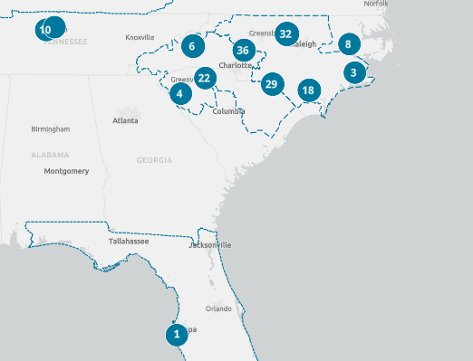

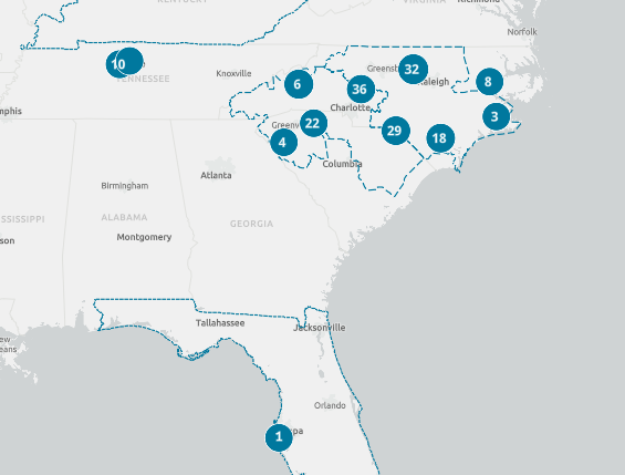

After I run this, I can see in the console that it is being applied. This is on a "clear" call, so there wouldn't be any addFeatures.
Map doesn't update:
It does lose labels when I zoom out:
Labels return when I zoom back in...(no additional searches applied)
Anyone have thoughts or ideas here? Again, this just recently started and it was all working fine before the updates.
