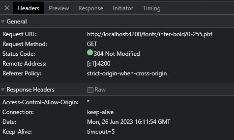

andrei_ste
Managed to convert the font but I still can't see any changes in the webmap. I copied all the files from the VPTK in a folder named inter-bold. From the browser developer tools, it seems that the font is fetched correctly but no changes are applied. Do you have any idea why this is happening? The font that I want to apply is Inter which is open source. Thank you for the response!
