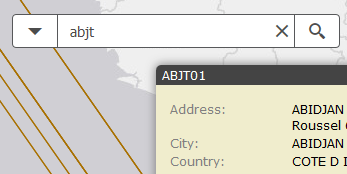

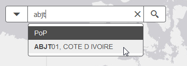

API JS Search does not display, in the search bar, the item selected by the user (from the suggested list) while the effective search works perfectly and display on the map the item along with the popup window.
Do you have any idea what I am missing here?

   Sorry the widget is just not designed for that when using FeatureLayer source. But you can add this feature simply by adding this code:
search.on("select-result", function(evt) {
  search.set("value", evt.result.name);

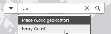

Thanks but why is it the case when I select from the 'world geolocator' ? I would expect we can do the same when the source is another one than this world geolocator.
