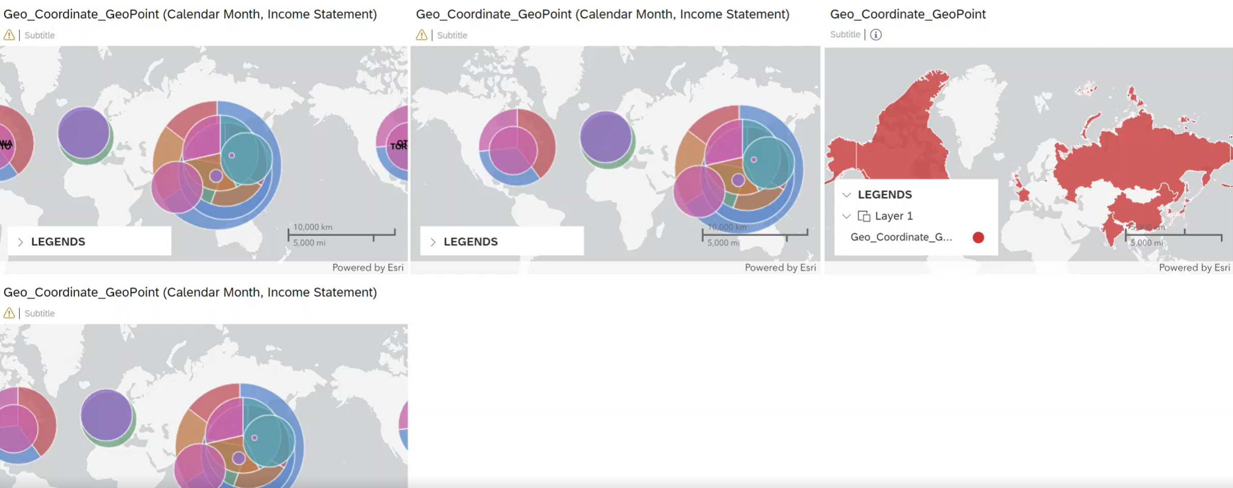

One of our developers happened to have React Dev Tools installed in his browser. We ran our application which rendered 4 maps in a browser tab:

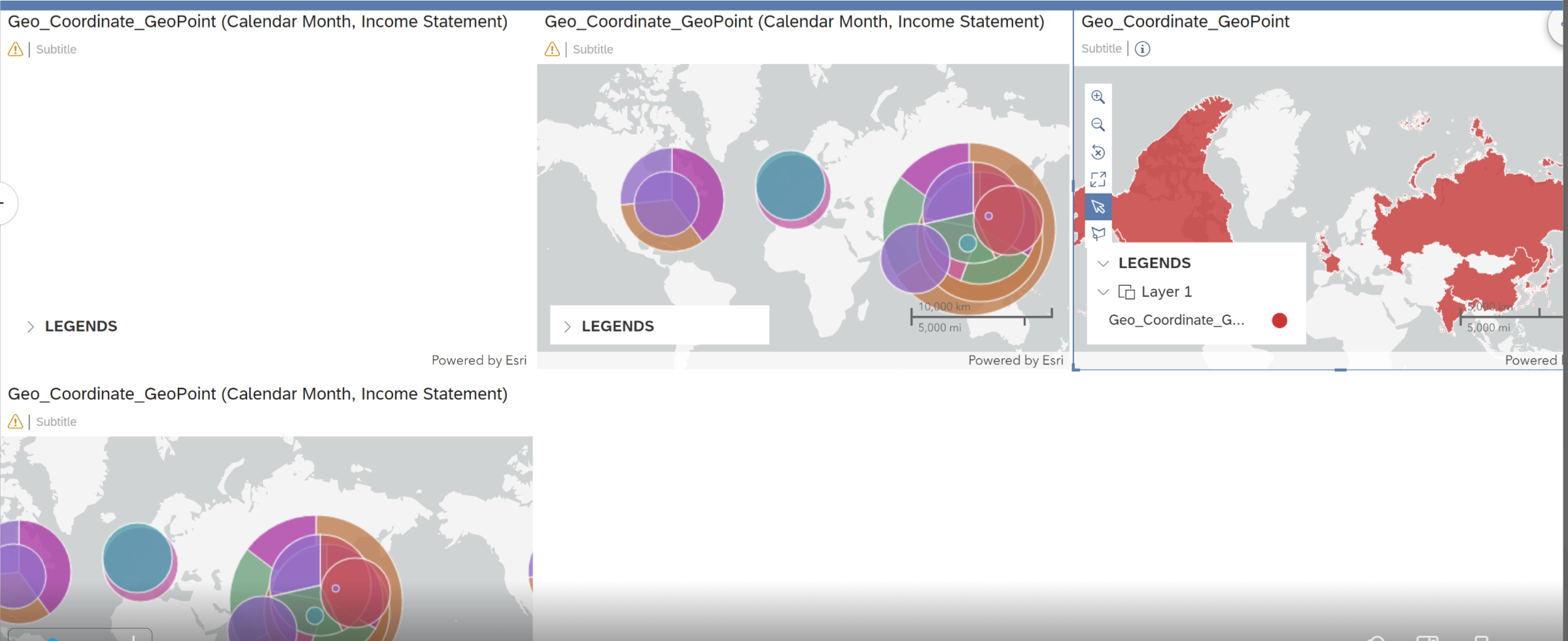

He went to another browser tab then left for some time ...more than 10 minutes. Came back and flipped back to the browser tab with our 4 maps, we noticed maps started disappearing, almost as if unloaded like this:
Attempting to interact with the 'disappeared' map caused all sorts of console errors like
The map was essentially useless and we could not interact with it.

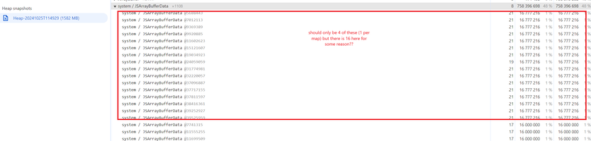

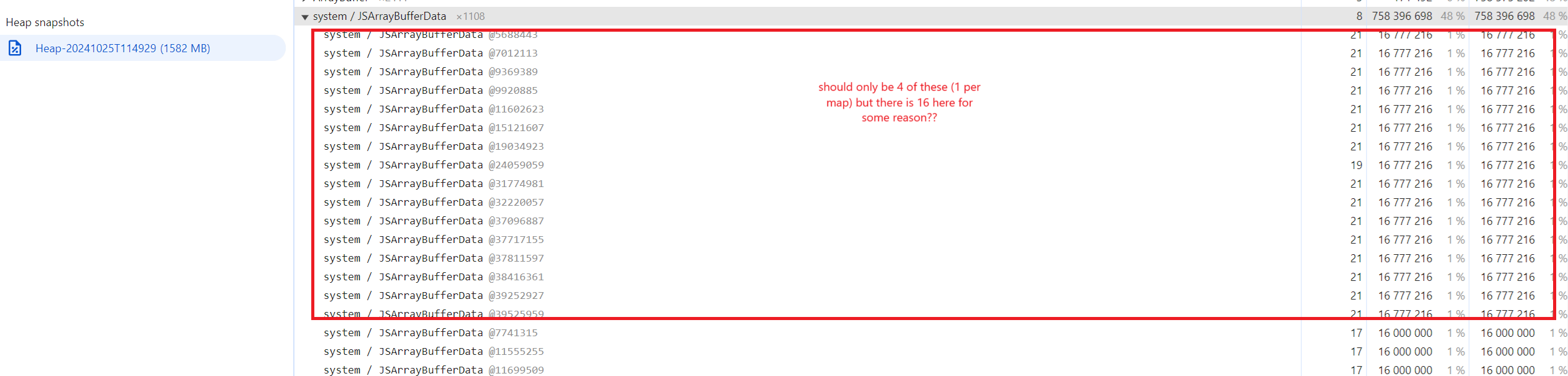

We then noticed the memory consumption had shot to 1.5GB and beyond.
We quickly grabbed a heap snapshot to look.  The most obvious thing that stood out was the sheer number of array buffers.  From previous memory analysis, i remember there is usually one of these per Map/MapView but here we saw upwards of 16 in that page with just 4 maps.

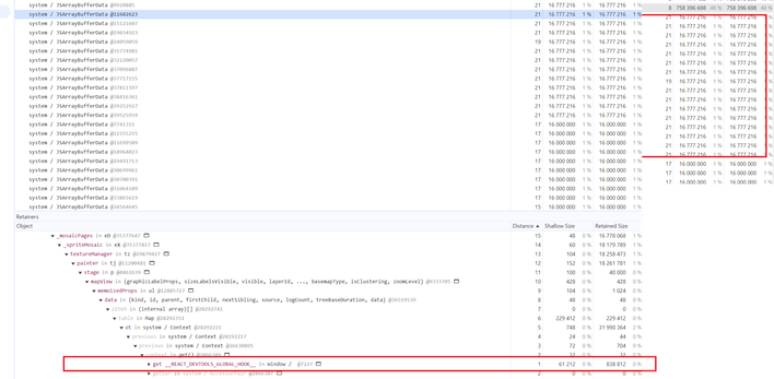

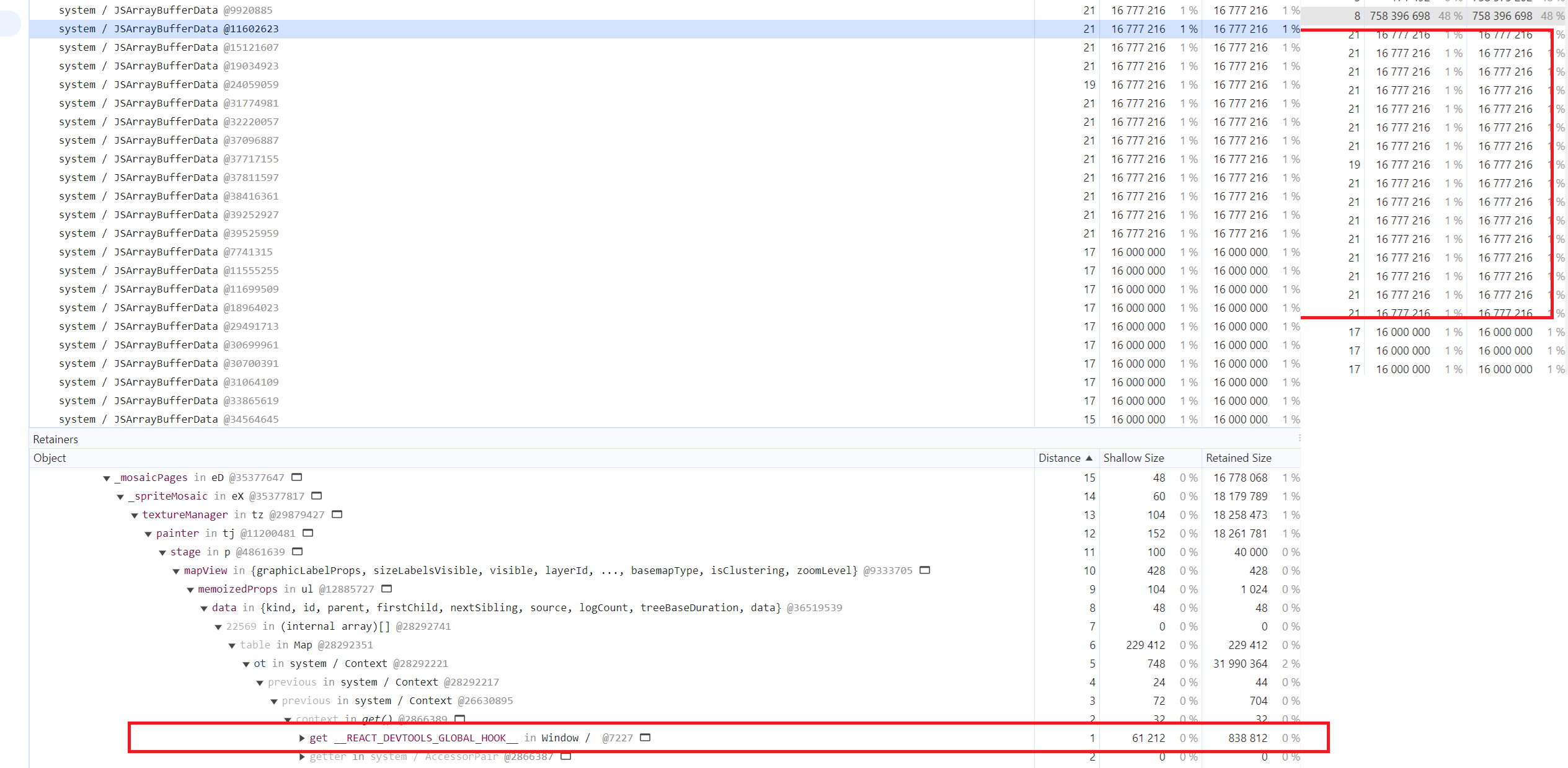

i then noticed one of them had a stack referring to the react dev tools.
So on a hunch, we uninstalled React Dev Tools and the problem completely disappeared!
