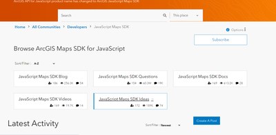

Would you mind pointing me to where I can create a "new idea"?
David_McRitchie
Sure thing, you can access the ideas page from the JavaScript Maps SDK page.
