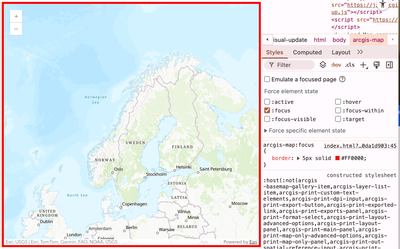

4andy
This was working at API version 4.33 but at 4.34 it doesn't seem to be. I tried a few things but nothing seemed to work. Anyone have any ideas on how to change the color at 4.34 when using map components? Thanks.
Sage_Wall
I think the focus color is controlled by the browser, but you should be able to overwrite it with something like this
arcgis-map:focus {
    border: 5px solid #FF0000;
4andy
That seems to add to it actually - I get both borders.
I can see the css outline colors and style and when I change it in the browser dev tools it changes the right thing but I can't seem to overwrite those properties in the css file itself and have them applied for some reason.
Sage_Wall
yeah your right, my apologies. There might be something in the shadow-dom of the component.  I'll ask around and see if I can get you an answer.  I haven't been able to figure it out either.  If I just add the :focus rule and then select the focus state in the dev tools it seems to work, but if I actually click on the map element I see the same thing you do with the interior blue border still present
Sage_Wall
There may be a big here @4andy you should be able to do it with a css variable, but it's not working as intended for the map.  It is working for other components inside the map however.  Still looking into this but a lot of people are out for the holidays at this time.
https://codepen.io/sagewall/pen/wBWvdmQ?editors=1010
If you wanted to do everything
  :root {
    --calcite-color-focus: #ff0000;
A single component (isn't working for arcgis-map as far as I can tell):
arcgis-zoom {
 Sorry for the previous bad advice and hopefully we can get the bug fixed.
