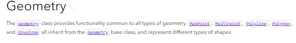

I am trying to add multiple geometries of different types - polygon and multipolygon on  the map. For this I have used Graphicslayer.
While creating the graphic object I am using "polygon" as the Geomtery type for POLYGON geometry but if we have a MULTIPOLYGON geometry, then what type should i pass in the geometrytype ?
Refering the Geometry , it does not give any option for Multupolygon
