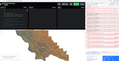

hi @BjornSvensson thanks for the reply.
i tried your example app, but its throwing console errors
how to handle these errors?
BjornSvensson
Esri Alum
@YashvitNaik - seems like the "PICT-CASANL21-ghAPblT72Z" no longer exists in that service you reference above.  If I change it to another layername like PICT-HIKAUA12-LIK2Cqnhav (that exists), and then zoom in a level or two, it seems to work fine.
