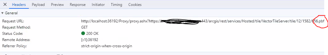

This code works fine when I have the vector tile layer ending with .json. But when I try to add vector tile layer from arcgis Server I am not getting any basemap  on the map. When I checked the error I found there is an extra ".pbf " after the tile url.
Any idea why this is behaving tile this and how to fx it?
