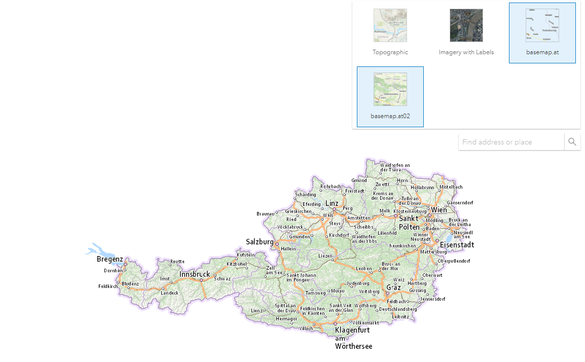

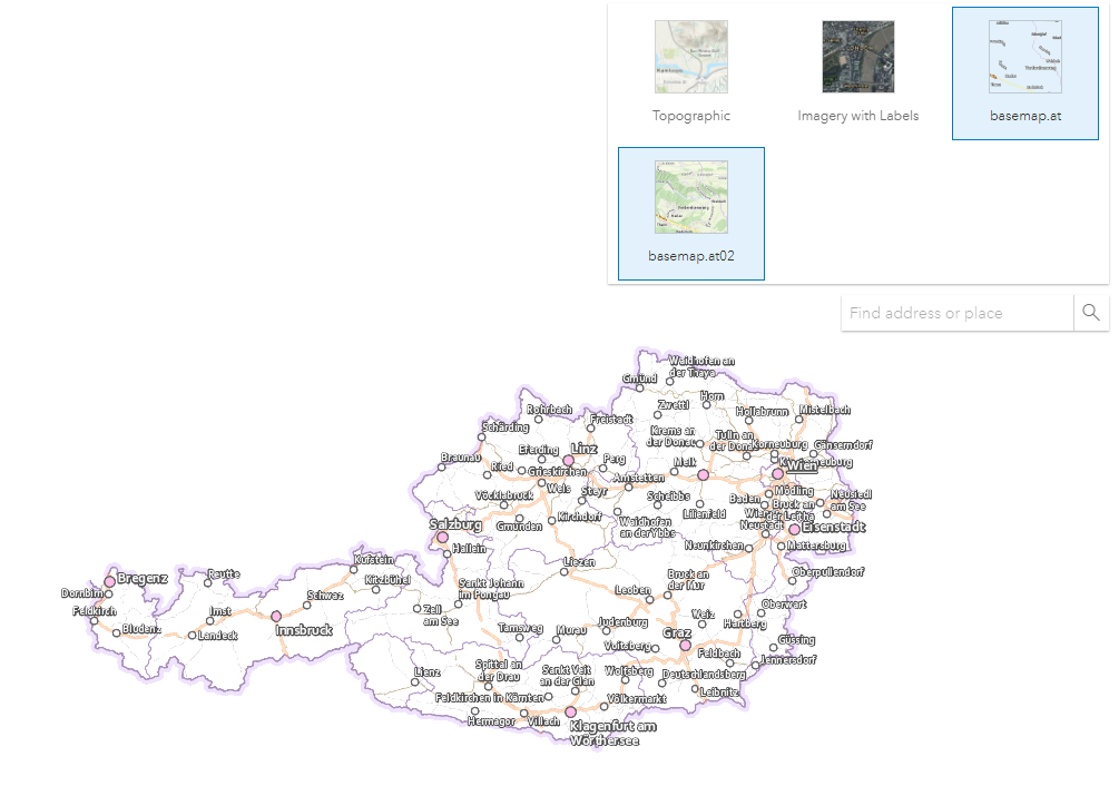

However, both options appear to be selected in the BasemapGallery widget, when only one is selected.
When option "basemap.at" is selected:
When "basemap.at02" is selected:
