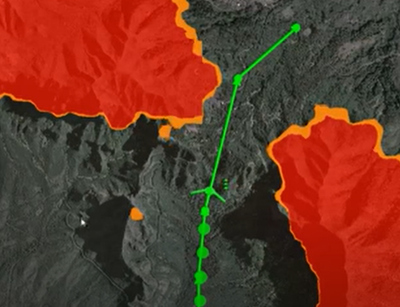

@ReneRubalcava If I wanted to overlay a color on the terrain above a certain altitude such as below, could I do it draping a polygon on the terrain?
RalucaNicola1
We don't really have anything like that out of the box in 3D at the moment.
