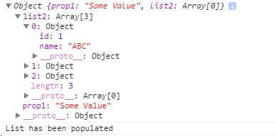

OwenEarley
Interesting pick-up Sarah. I haven't noticed Chrome backfilling objects in the console before.
I did a quick test (make sure to open the developer tools console and hit F5) and found that if you do not immediately expand the object node to view its properties then the object is updated retroactively by Chrome:http://jsbin.com/hakuyuhevi/3
Also, note that the information in line 1 shows list2: Array[0].
However, if you expand the object node before the code has populated the array, list2 shows as empty:
This is definitely something to be aware of in debugging.
