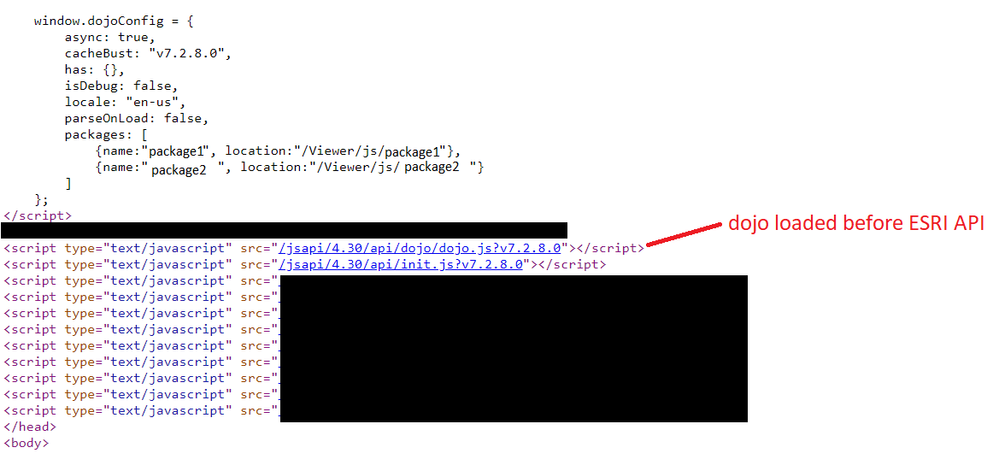

Yes, it's still valid, but getting everything set up is slightly more complicated than previously.  Migrating from 3.x would've been a bit easier prior to 4.20, because dojo was still packaged with the API in those days.  When I migrated our platform in the days of 4.16 - 4.18, I was able to eliminate about 94% of the references to dojo, but some of those remaining references still exist to this day (although with charting components hopefully coming out of beta in the near future, we might be ready for the final push to remove dojo entirely).  When the dojo-less 4.20 came along, I thought "oh, I'll just load dojo from the 3.x install instead", but it didn't work out that way, because the 3.x loader and the 4.x loader didn't play nice together.  To make this work, I ended up copying the dojo, dijit, and dojox folders from the 3.x install into the 4.x install like so:
The screenshot below shows the code for loading dojo separately from the Maps SDK for Javascript&colon;

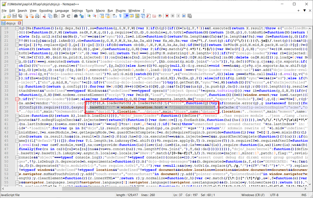

For good measure, the screenshot below shows the value of the "baseURL" setting in the dojo.js file which matches the environment displayed above:

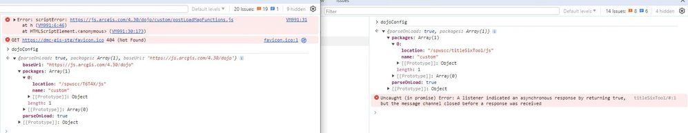

Both will error out with the same message. For the heck of it, here are the consoles from my 4.x attempt on the left and the existing 3.x app which works fine. The only difference in dojoConfig I see is that the 4.x dojoConfig specifies baseUrl whereas the 3.x dojoConfig does not.

In my dojoConfig, I have tried providing a full URL path for my custom modules but it keeps appending that to the end of the core ESRI baseURL. This shouldn't be so difficult but, if I have to append them all into an 8,000 line JS file, I'll do it. 😩

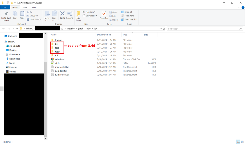

No, I don't believe I would have any issues doing so. I kinda considered downloading the API as an option to keep my 3.x app running (I know ESRI isn't pulling the CDN plug for awhile but still).
The biggest challenge seems to be finding the actual 3.x download. I keep getting in a circular loop while looking for it. Ugh. I'm too old and too close to retirement to learn NPM. 😆
JoelBennett
MVP Regular Contributor
It looks like they've taken down the 3.x links.  The direct URLs still work though...for now.  Go here, copy the URL from the JSON text it outputs, and paste back into your browser.
