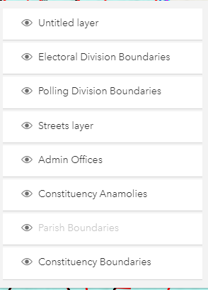

ChesouyeCoye
I am having the same issue. I have attached a snippet. I do not know why there is a untitled layer as I have done weeks of debugging and it doesnt work. untitled layer.PNG
