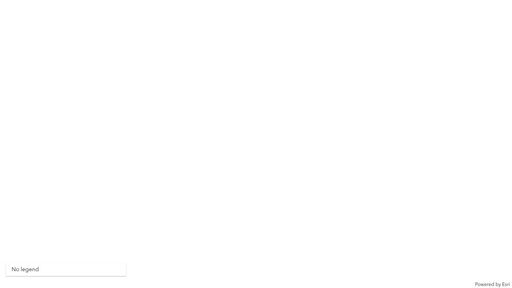

I'm using a CIM symbol to visualise a PictureMarker with scaleX and visualVariables size, rotation. The image is not displayed like it should be, when zooming in and out. (Scaling issue - aliasing)
codepen:
To reproduce: zoom in and out and rotate.
https://codepen.io/michaelk95/pen/JjVXaOE

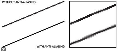

Issue:
What I"m expecting:
Even with SVG type images

Hi @michaelpoa - we've made some improvements to the aliasing issue you were seeing for the version 4.32. Can you try this out against the /next development version of the API and let us know if this fixes things for you?
