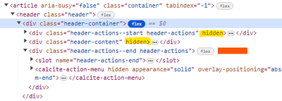

Hi.
Is it possible to hide the HEADER totally? (4.29)
Release 4.29
Tried adding actionBar: false and heading: false.
HTML result:
It should be possible to add the 'hidden' property to header-actions?
Thanks
