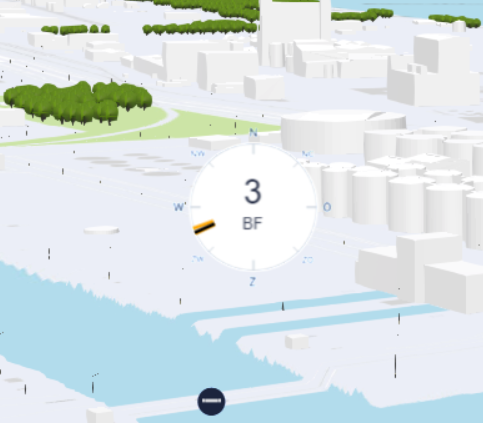

Hi!
It's not possible to create a CIM Symbol with vector markers with custom text symbols.

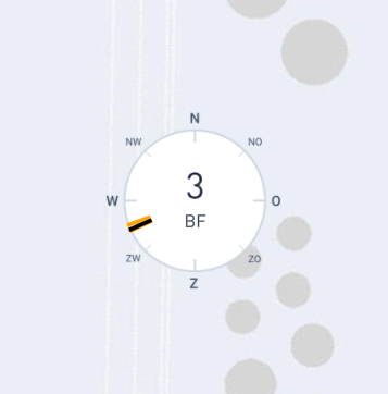

Trying to achieve:
2D: (working as expected)
3D: (Only working with version 4.21)
 It's working with v 4.21 but not with v 4.25.. because text symbols with CIMPolygons are not supported.
CIM symbol of type 'CIMPolygonSymbol' is unsupported in 3D

Is there any way to achieve this CIM visualisation with text? Or is it planned for the next release?

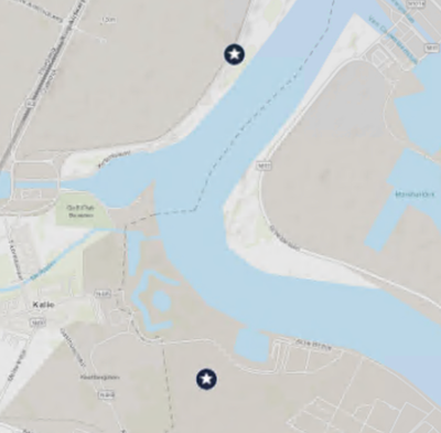

in 2D (mapView) my CIMSymbol is looking fine (with a custom font*)
*custom font and my esri config:
esriConfig.fontsUrl = './assets/font/';
When switching to 3D the CIM symbol can't find the custom font? And it looks like:
Is this a known issue? Should I reapply my custom font or renderers or ...?
