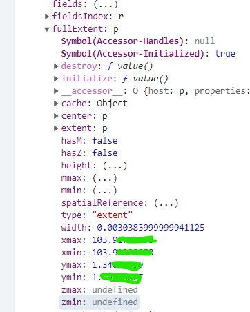

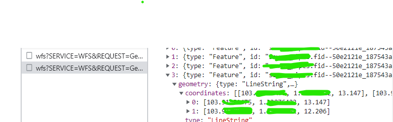

I have a WFS (v2.0.0) containing polylines with Z value hosted a local Geoserver. I am able to render the polylines on webscene, however, the z value seems to be missing. It is rendered flat at 0 elevation. The response from Geoserver clearly contains z value (pls refer to the screenshot).
I have tried the same using ArcGIS Server (WFS) and it was working with no issues.  Is there anything that I have missed out?  I've also upgraded to the latest version of arcgis/core (4.26.5) and played around with the elevation
