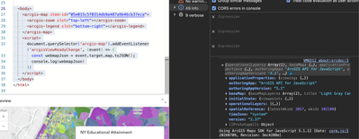

You can call .toJSON() on the map.
  <body>
    <arcgis-map item-id="05e015c5f0314db9a487a9b46cb37eca">
      <arcgis-zoom slot="top-left"></arcgis-zoom>
      <arcgis-legend slot="bottom-right"></arcgis-legend>
    </arcgis-map>
    <script>
      document.querySelector('arcgis-map').addEventListener('arcgisViewReadyChange', (event) => {
        const webmapJson = event.target.map.toJSON();
        console.log(webmapJson)
    </script>
  </body>
