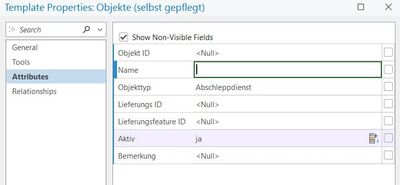

Yannick-Atos
@BrantSollis2 We cannot edit the feature template via the Web Map Viewer. Our data is stored in an Enterprise Geodatabase, so the template is defined at the feature service level and originates from ArcGIS Pro.
The ArcGIS Pro template itself does not contain a whitespace:

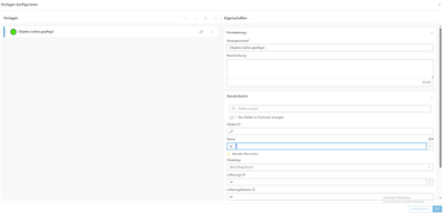

The whitespace only appears in the Map Viewer template configuration, but there it cannot be removed or saved:
