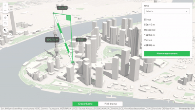

The measurement Widget is great, but the point, line, and polygon symbols used by the Widget cannot be changed. In many cases, the user needs to change these symbols in order to make them more consistent with the style of the application.
It would be nice if user could change the default symbology of line and area tools that comes with DirectLineMeasurement3D and AreaMeasurement3D widgets.

I have an additional question: the default measurement symbols have a style that help you interpret the result (checker squares and markers). Would you want to replace all that with a simple line or a plain polygon for example? Or what kind of symbols would you want to replace them with?
What we are also considering is just exposing the color of these graphics and the users could change that. But the visual cues in the symbols would still be there, which in my opinion is a good thing because it makes it much easier to interpret the results.

I agree with you, my focus is also on changing the color of the symbols.
To add, for the measurement widgets in 2d, such as AreaMeasurement2D, DistanceMeasurement2D, etc., I found that there are some unexposed properties to change the symbol color. Please see demo:https://jsbin.com/xeqobut/1/edit?output 。But for the widgets in 3d, no corresponding properties were found.

No, unfortunately in 3D you can't use internal code to change them. We're discussing right now what is the best approach to take because in the visualizations for the measurement widgets are currently not part of the API symbology.

With Maps SDK for JavaScript version 4.28 released in October 2023, it is now possible to customize the color of the interactive tools, such as the measurement widgets, in both 2D MapViews and 3D SceneViews
See more in the release note:
https://developers.arcgis.com/javascript/latest/release-notes/#color-theming-for-interactive-tools
And in the sample: https://developers.arcgis.com/javascript/latest/sample-code/view-theme/
