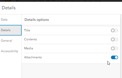

When showing attachments in the detail widget of an operational dashboard by enabling media you cannot currently remove the filename being displayed with the image. It would be great if we could disable this/have the option to hide it.

Hi @BjornSvensson  thanks for your reply. There isn't an option to change the displayType in the Configure menu of the dashboard's 'Details' element:
Any other ideas?

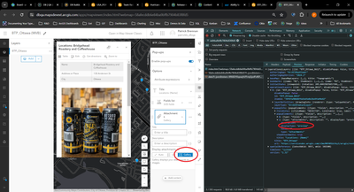

patrickb
Rather than there being a specific toggle for attachment filenames on/off in the Details config dialogs, it will respect the 'Display attachments as ...' setting on the layer itself (see Map Viewer example below).
