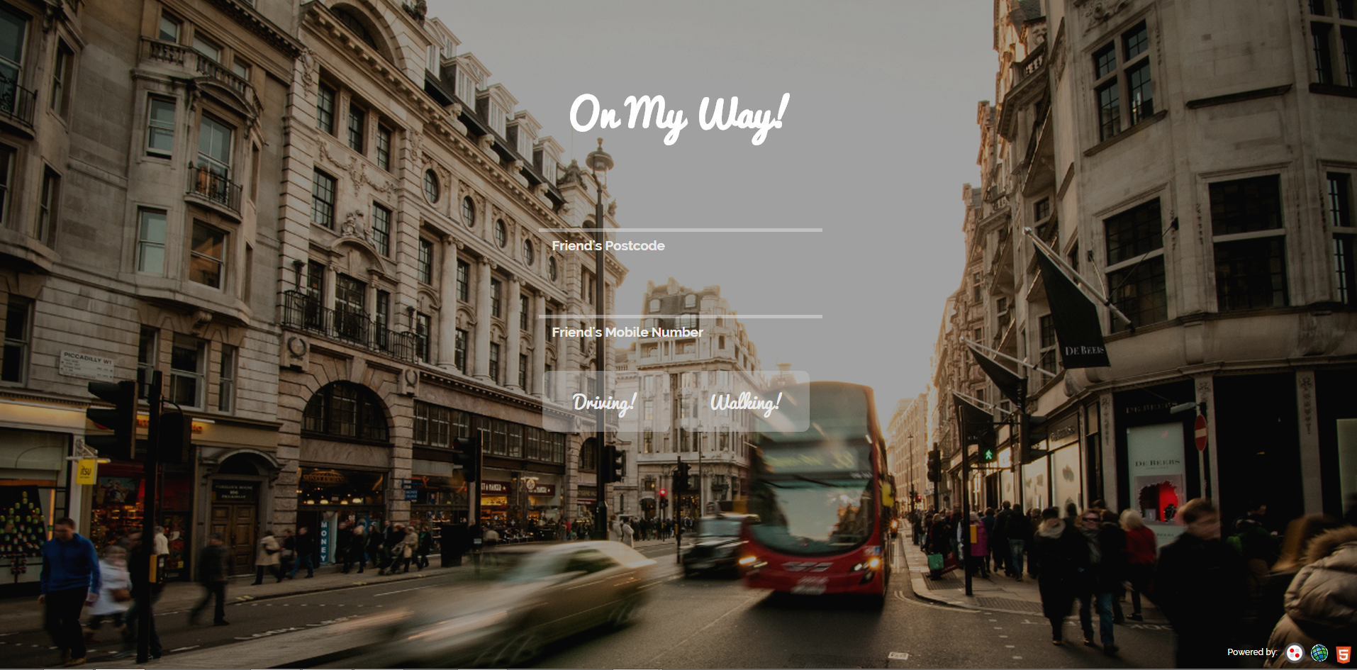

  1. User A inputs a friends Postcode (ZIP Number?!)  and friends mobile number. The user then selects if they are driving or walking.

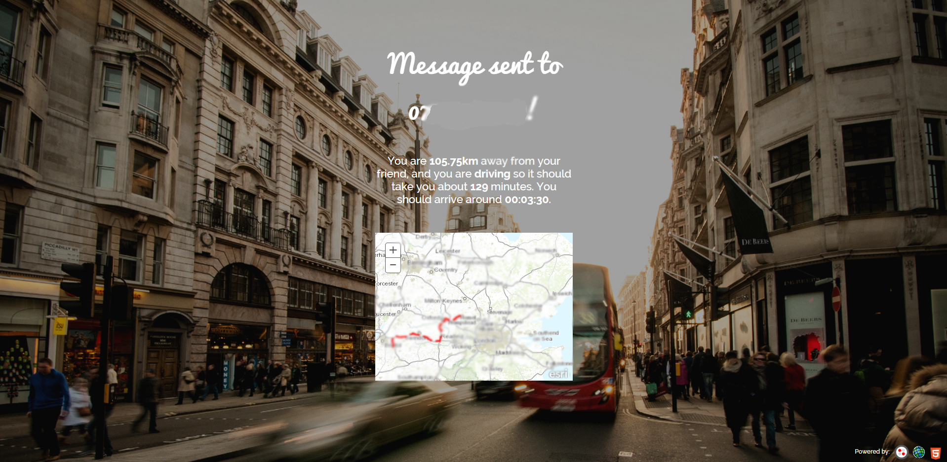

  2. User A is then presented with a screen informing them there friend has been texted with their mode of transport and how long it will take them. They are also given a map demonstrating the suggested route
  3. User B is delivered a text with this information.

Front End
The front end made use of some of some really nice input effects (built by Codrops; see here for GitHub repo and here for the article). I went with the 'Yoko' style which gives this cool 'popup'-like user input with the label text underneath. The app also made use of some Google Fonts; Pacifico font for the title and Raleway for the input labels / main text. The background image was a open image from unsplash.com
Once User A has submitted the details (User Bs phone number and Postcode) they receive a map with the suggested route to User B on. The map takes the route JSON passed back from the REST request made in the PHP script via AJAX.
