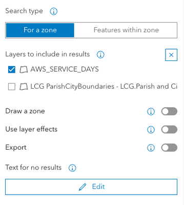

If it does work as expected here is the configuration used to get only the AWS service days to show up in the list.
Screenshot 2025-08-06 at 1.05.33 PM.pngScreenshot 2025-08-06 at 1.05.33 PM.png
