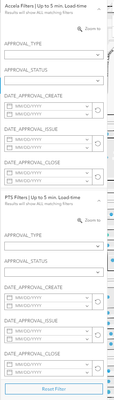

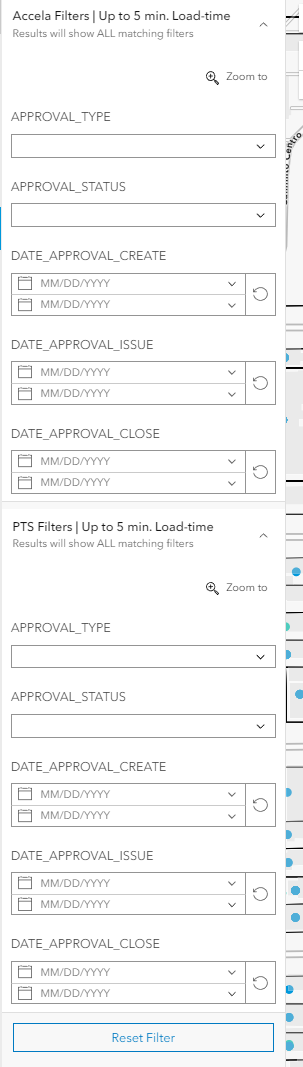

Tips for improved Filter load times for sidebar instant app.  I have two Rest service endpoints being shown in the map.  Both are fairly large 800,000, and 200,000 records.
Are there any configuration options within Instant Apps to speed up the process?

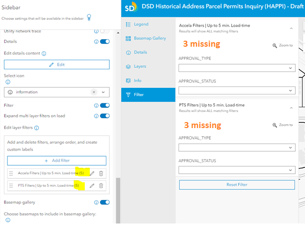

It appears that the date filters do not show while they are building.
Date filters do seem to finally load in about 5-10 minutes
