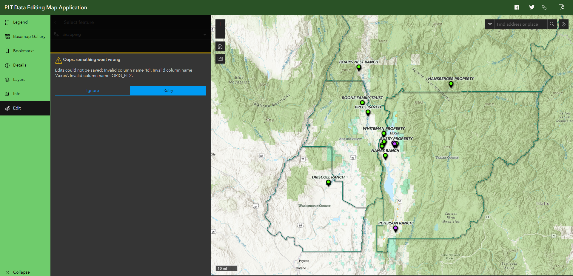

The sidebar instant app will not let me edit anymore because I deleted fields out of my schema that were not being used. I tried to refresh the app by reconnecting the map and republishing the app, just to try and get the software to understand that the fields are deleted, and that didn't work. I then tried to recreate the app from the bottom-up with the new layer that no longer has the fields, and it still gives me the same error. I'm at a loss:

@KaraUtter1  are you able to use the edit tools in the new Map Viewer to edit the web map used in the app?
KaraUtter1
No, it gives me the same message. How strange.

I wonder if the layer is in some sort of corrupt state? Looks like one of the  fields removed was an id field? Perhaps there's something going on with that.
KaraUtter1
Well, that was an un-used ID field where most of the values were NULL So that would be really strange for AGOL to hang up on it when there is already an ObjectID field and GlobalID field fully functioning. Do I have to create a new hosted feature service?
