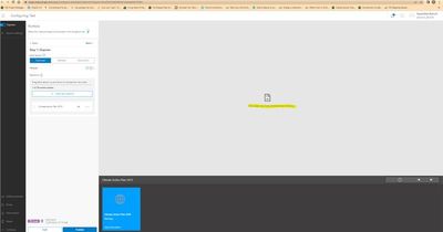

Hello, I am getting an error, while embedding a PDF URL (published  on AGOL) in Instant Apps. How can I fix this?

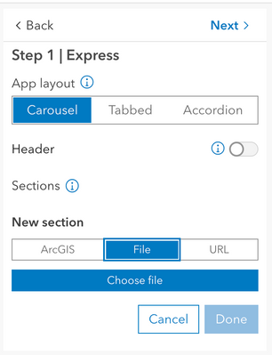

It's recommended to upload the PDF directly from Portfolio's configuration page, using the 'File' option.
The browser is not allowing the hosted PDF from displaying as there are browser security restrictions in place with certain content from being directly embedded into Portfolio.
