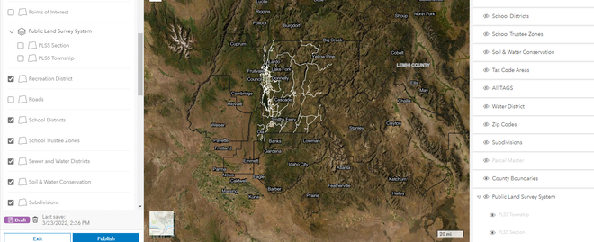

Hi Kelly, just noticed something else. We are unable to turn on or off a complete map image layer. If you see my screenshot below, I have PLSS map image layer in the list, and even if I don't have either of the layers marked to be included in the list, the app keeps them in the list.
