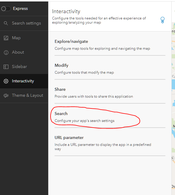

ArmstKP
When I click on Interactivity and then try to click on Search, nothing ever happens.  It's like I can't even click on Search.  After trying to click on Search, I then have the problem of not being able to click on Sidebar, or About, or Map....nothing.  I then I have to refresh to do anything else...  I have tried using Incognito and that doesn't make any difference.  Using Chrome, haven't tried other browsers...

Hi @ArmstKP
Sorry to hear that you are running into this issue. Unfortunately, it is an issue with locators and not having the ArcGIS World Geocoding service listed as a locator in the organization. We are looking into this issue and are planning to have a fix for the ArcGIS Online update later this month. In the meantime, the workaround that I mentioned in this post is the best way forward. Let me know if you have any additional questions.
Thanks!
Sarah

ArmstKP
It looks like the issue is related to locators.  If you or your organization don't have ArcGIS World Geocoding service as one of your locators, the odd behavior of not being able to configure the search happens...

ArmstKP
@SarahMcDonald_Esri Thank you for the information on this bug.  I will just wait for the update as we do not want the ArcGIS World Geocoding service as a locator in our organization.
