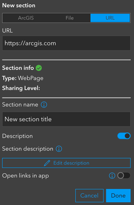

Yes, you are now able to embed web pages to Portfolio. Found in the app configuration here:
Although embedding web pages is supported, please note that the embedded web page must also support being embedded.
