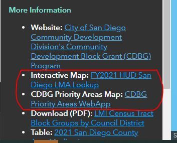

YukoOliver
Hello @KellyHutchins
I clicked outside the edit box, then I enabled/disabled the "Open as splash screen" option, and it did save and open it as a splash screen, but it didn't reflect the contents in the edit box. See the screenshot. (it's behind the edit window, but you can see the two lines with red arrows).
It seems like everything else works but editing the introduction panel content.

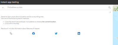

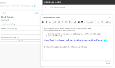

RyanBohan
Hi Kelly,
I am seeing the same issue on AGO.  I created a brand new webmap using the new map viewer adding only a Living Atlas layer USA Parks.  Next created a Zone Lookup Instant App.  Edits in the intro panel do not show in the published instant app.
Published Zone Lookup Instant App

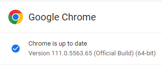

 I tried clearing my cache and cookies, and am on the latest version of Chrome
