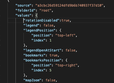

Once in, you'll have two ways to implement the fix. You can add rotationDisabled as a URL parameter or at the app level, if you're comfortable making changes to the JSON in AGO Assistant you can do the following:
It’s a good idea to make a copy of your app and test this workflow out before doing it on your real application.
  1. Log in to AGO assistant. https://assistant.esri-ps.com
  2. In “My Content” find your app then in then click the {} button to edit the items json
  3. In the JSON editor click the “Data” tab then click the “Edit JSON” button
  4. Then find a spot in the json in the values object to add rotationDisabled and set it to true.
  5. Save and test your app

Okay good news, I was able to reproduce the behavior and we should hopefully have a fix for it on Monday.

Hi, I didn't know quite what I was doing, but managed to add rotationDisapbled in the JSON under Values and wrote true.  Also added the URL parameter at the end of the app data before I figured out the JSON editor.  I am still not at home to work on this, but the horticulture person working with me will test out on Tuesday.  Thanks ChryseMorales.  I think it would be a good option to turn off rotate in all the apps.  Thanks for working with me.
