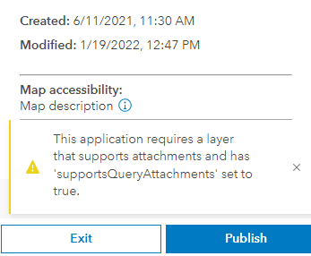

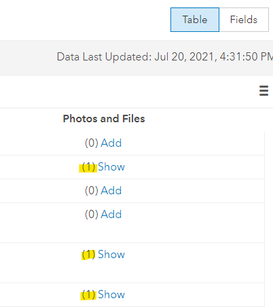

@RyanLibed we're still seeing this error. The Web Map has two hosted Feature Layers with attachments enabled and present in the ArcGIS Online data table but we're still seeing this error.
Error appearing in Attachment Viewer:
Attachments enabled in ArcGIS Online:
This post Re: Attachment Viewer app - Esri Community suggests the attachments have to be on the feature table. Does this mean the Attachment Viewer won't work with hosted feature layers which have had attachments enabled from within ArcGIS Online?
