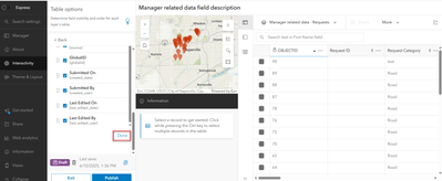

I'm not able to get the Manager Instant App to honor any Table Option configurations for a view layer in a webmap. For example, I'd like to turn off OBJECTID in the table and reorder the fields alphabetically. When I uncheck OBJECTID and Publish the edits, the field hasn't been removed.
Also, the UI for Table Options is overflowing off the left and right sides of the panel, so its difficult to read.

After you are turning of ObjectId and reordering the fields, are you clicking Done button? If no, please scroll to the bottom of the Field picker list, you will see this button. If the button is not clicked, changes will not take place. The reason I think about this is because the button is hard to find if you don't know it existed.

Thank you @AzizaParveen1 !
Yes, you are correct that I didn't find the Done button. I had to scroll through to the bottom, which I hadn't realized was even scrollable.
Hopefully this UI/UX gets fixed soon 🙂
