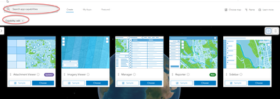

@sblazeycov Only exisiting widgets in the app can be disable/enabled. If a tempalte does not contain a specific widget it can't be added. Basic does not have edit capabilities. For editing features, Sidebar and Manager would be good templates to take a look at. One way to find Instant Apps that have the capabilities you are looking for is to use the search on the Instant App home page. You can enter search terms and it will return all apps with those features.
