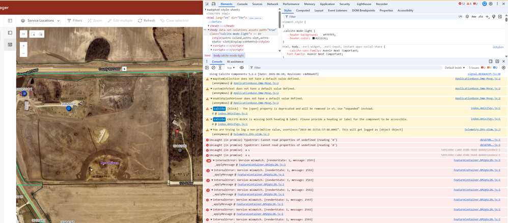

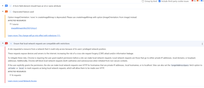

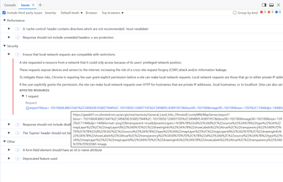

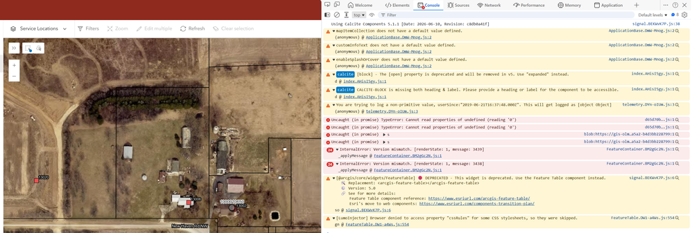

@AzizaParveen1 here is a screen shot of the developer tools. Again - is so intermittent and clearing cache does not solve the issue. Browsers are all updated to most recent version for Edge and Chrome.
Edge:
Chrome:
Also:
We have a service on our arcgis web server (that's in the maps basemap) that seems to get involved with the select tool? And there's something going on with that request maybe that's really intermittent? Our server is 10.91 (stand alone, not federated, but also inside of cloudflare). When I removed this service from the map, I could select again.

@AzizaParveen1 I ended up removing those bugging services, but still had the issues. All the developer tools seem to indicate that the Feature Table is a depricated widget. There is a feature service with 75,000 records in (hosted). I wonder if it struggles with this not sure. Either way, I've moved away from the Manager Instant App to Experience Builder. And do not have any issues performing the same functions (select from table or map) etc.
