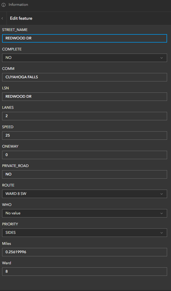

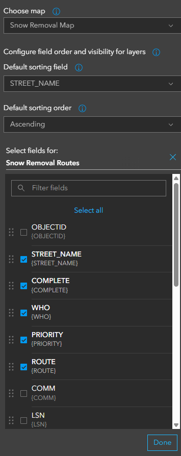

I have a Manager instant app that is used for editing a layer. I have a configured pop up for the initial selection. Then when "edit" is clicked, it is supposed to only show the fields that I have checked in the Layer Visibility section of Modify. However, it shows all of them still.
I have an identical manager instant app but for a different map. It works as it should. I am not sure why this one won't. Below are screenshots of my selection.

The layer visibility you configured does not affect the form. You can choose which fields to display in the form, in what order, & more when you author the form in Map Viewer or Field Maps Designer. If you haven't done that, a list of all the editable fields is displayed by default.
