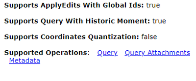

when you check your Feature Service, has this service Attachment enabled, and please check the QueryAttachment is present in the REST page of the layer in the Feature Service:
Vladimir
amarcz_cc

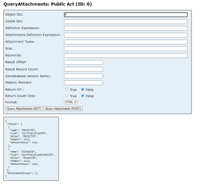

I do see that as an option, and when I query an attachment, I get the following:
VHolubec
It should work then - could you share the URL of the Serivce @amarcz_cc?
