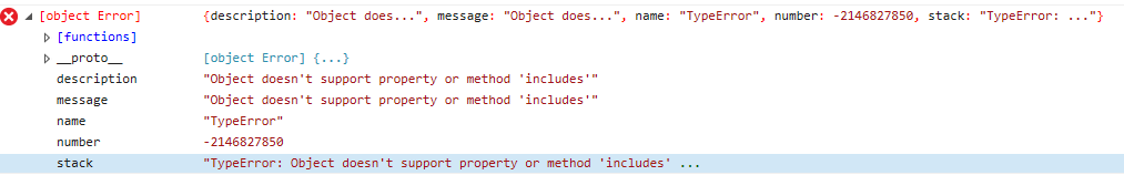

I have a GPServer Task see this link THE Extract Data Task and its on ArcGIS server 10.3.1 which is giving me problems when I access it via a AGOL Hosted Viewer and using the Geoprocessing Widget  in Internet Explorer 11, the same Hosted Viewer including  gp service and widget works perfectly in Chrome no errors reported.  The error I get in IE11 is
Console error in IE11
I have several GP Data Extract Tasks in several viewers and they all fail in IE11

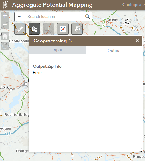

This is the error manifested on the widget
Widget Error Data Extract
The output file is generated perfectly but the widget cannot display the link
This is the response body just as the error is displayed.......
{"paramName":"Output_Zip_File","dataType":"GPDataFile","value":{"url":"https://secure.dcenr.gov.ie/arcgis/rest/directories/arcgisjobs/apm/apm_extract_2017_gpserver/ja0a922..."}}

I asked a colleague to take a look and he agrees with me that this is a bug in the code, in so far as that IE11 does not support the method 'includes', he took a look into the code being passed and this bit is where the issue appears to be(?)
 else if (a.dataType.includes("GPDataFile") || a.dataType.includes("GPRasterDataLayer"))
                        p = b.url ? p + ('\x3ca target\x3d"_blank" href\x3d"' + b.url + '"\x3e' + b.url + "\x3c/a\x3e") : p + (a.paramName + ": null");
However since I'm using AGOL hosted I don't have an option to fix this code unless I self host which unfortunately is not an option in this case.  I have trawled AGOL - APPS and found many hosted viewers with exactly the same issue in IE11.
