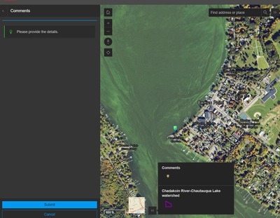

ErikBreedon
Hello, I have another question. After placing a point on the map, it simply displays "Please provide the details." What is happening? Shouldn't in bring up a dialog to enter information?
SubaKrishnan
@ErikBreedon That text is a tip and it shows by default to guide users. It should display a form in that panel. Could you check if you have fields enabled in the form? Do you see the form and fields in map viewer?
ErikBreedon
Thank you for all your responses. That was the issue. I did not have the fields added to the form.
