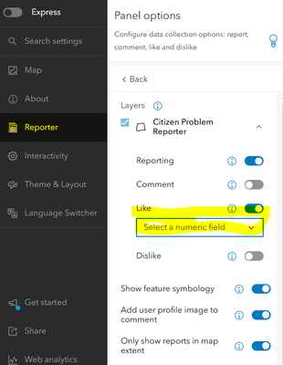

Hi @AneteZvaigzneLV  Here are the steps and it's very easy to configure:
  1. Open the app's configuration
  2. Click 'Reports' tab on the left, click Panel options
  3. Expand the layer where you'd like to enable Like and Dislike.
  4. Toggle on the feature and choose a numeric field to store the values.
The feature layer must have a numeric field to store it otherwise the feature can't be enabled.
Things to try:
  1. Try updating the numeric field in the attribute table in map viewer to see if it's working.
  2. Check for console errors, if you see any errors as you click on the like button in the app. Pls share if you get any errors.
If you still have issues, please send me a DM with an app link or you can open a support ticket through Esri Support website. Hope this helps. Thank you!
